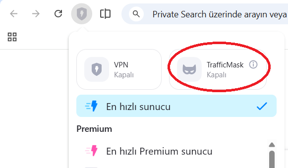

I'm installing Aloha from scratch, but TrafficMask won't open. It worked perfectly fine on the old 4.11.0.0 version. It doesn't work on newer versions.
Files: rec.mp4
Hi, are you using the latest 4.18.0.0 version?
Yes i am using 4.18.0.0 version on windows 11 25H2. This problem started with version 4.17.0.0. TrafficMask button not working. not active.
